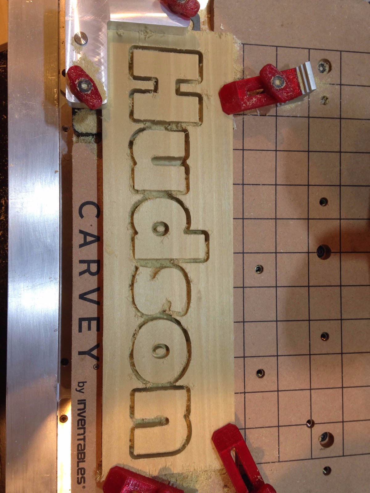

I carved the bottom layer of the sign from a ¾” piece of hardwood.
After I vacuumed this piece, I was ready to carve out the letters for the top layer of the sign from ½” thick hardwood. I got to use another new Easel feature, Interactive Tabs, for this step.
When cutting all the way through a material, like I wanted to for the letters, you can use things called “tabs” to hold the cut-out pieces in place. Tabs leave small, thin pieces of the material in tact around the perimeter, preventing the design from cutting out all the way and flying around inside your machine. Easel now allows you to choose the size and placement of tabs, so you can customize them for easy removal when you’re done carving.
You can see that the tabs prevented my letters from dislodging while being cut.
I removed the tabs, then sanded and painted the letters. Here is what the finished sign looked like; I hope he likes it!
