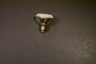

A package came in the mail from LED shoppe. All the way from Hong Kong!
In an effort to make LED technology accessible in a kit form, we selected this bulb for our lamp. 60 LEDs attached to a E27 socket. Out of the box ready to go on 110v, no soldering required.

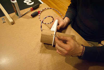

The side brackets fit into place on the main head piece. They are then bonded with acrylic cement.

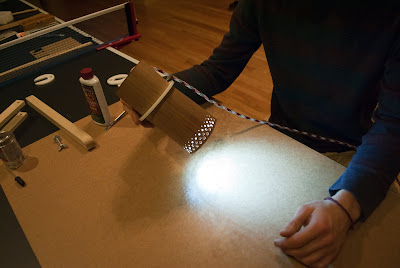

Add the bulb and...
Test to make sure we have power. Good to go!

The lamp shade creates a beautiful pattern, both at point and in the light emitted on the table.
Lights on. Fits well with our IKEA desk. The lamp moves smoothly, holds its position, and can cover nearly every inch of this table with light.
